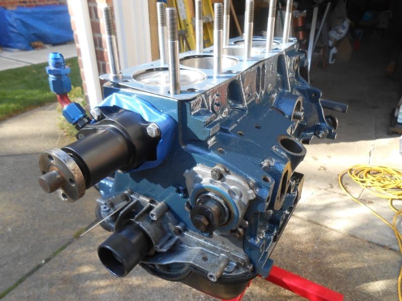

#4
Painted the short block with POR-15 Ford Blue, installed the Kevko pan using some Permatex Right Stuff. Installed ARP head studs, Felpro 1035. Installed the Esslinger water pump & billet intermediate shaft.
