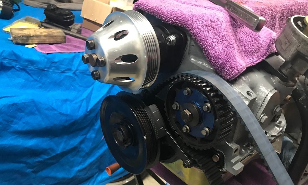

I bought the Essy serpentine WP pulley to put on the bird. It is a lot lighter than the steel stocker.
I did notice it is 5" diameter versus 6" on the stock pulley.
I think the stock crank pulley and stock WP pulley are the same diameter so putting this pulley on will effectively overdrive the water pump.
A couple of thoughts:
Would the increased pump speed/load negate the benefit of the lighter mass of the new pulley?
Would the increased pump speed lead to pump cavitation at high engine speeds? (8000 engine rpm would be 9600 WP rpm)This will be the Essy WP as the pulley hole is too big for a stocker.
I'm sure there would be a cooling benefit at lower engine rpm as the pump would be turning faster than engine rpm but is that a good tradeoff for more power loss up top?
Essy has a 2.9" serpentine crank pulley but that takes things way too far in the other direction making everything turn too slow IMO, especially for a street driven setup that needs reasonable WP and alternator rpm at low engine speeds.
Thoughts?

Bob, the Essy pulley worked with a stock pump? The hole in my Essy pulley is too big for my stock pump but fits perfectly on my Essy pump.

On a stock pump ...
http://i1192.photobucket.com/albums/aa32...xgvjrv.jpg
On Esslinger billet pump
http://i1192.photobucket.com/albums/aa32...pt6byz.jpg
Sorry no better picture on stock pump

Looks like Bob used a steel sleeve on the stock pump, Chris. :dunno: <font color=navy>
