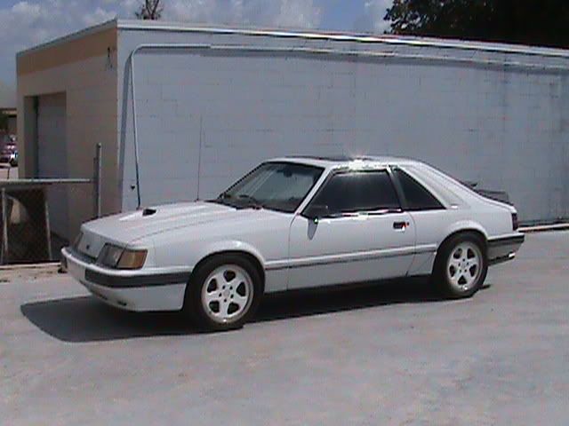

A friend of mine owns a Performance Shop, I used to work there, and has an SVO came that in on a wrecker this week with what the current owner said was a timing issue. The former owner has put a lot of work into the car. It came in and right away he noticed that the cam and ignition timing was off. That prompted his call to me.
The current owner was street racing someone else we know, and was ahead of a cammed out 4.6 3 valve Mustang. Hit second gear and said something went boom, lost power, and kept popping and backfiring. He thought it jumped timing and tried to put it back, everything was off.
I went over and got everything back in time. Checked the compression avg 155# all within specs. Getting spark, getting lots of fuel, to the tune of fuel soaking the plugs. It tries to fire, but just wont really catch.
It has a Microtech LT-8 stand alone engine management system. I downloaded the software and will head back up there tomorrow to work on it again.

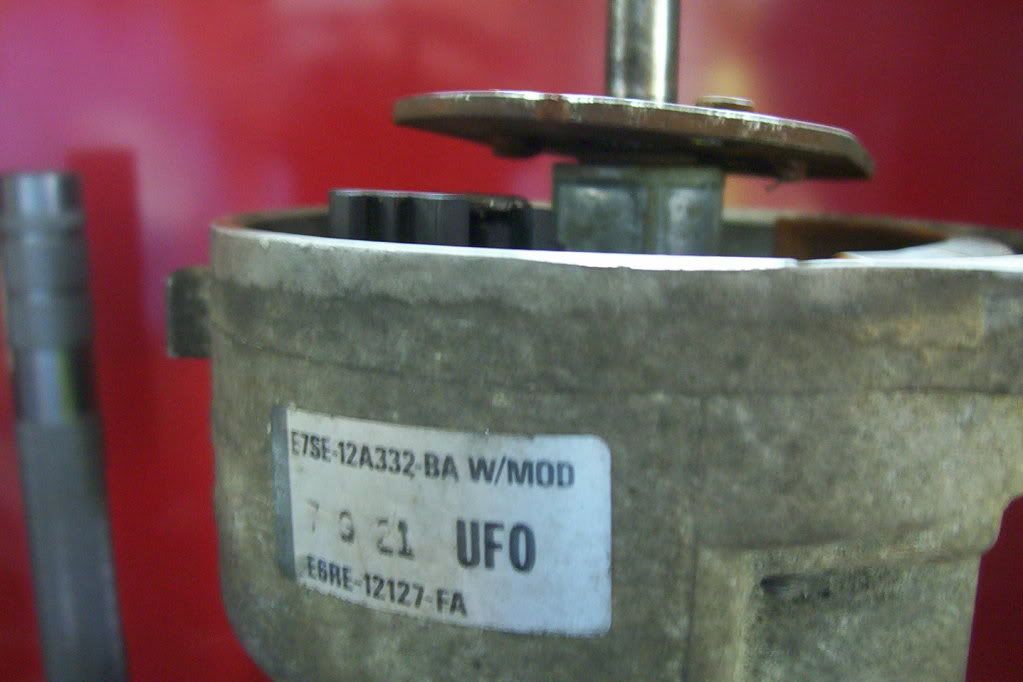

I had a 2.3 turbo act up as far as timing. I timed it twice. It finally done this. The rotor plate came loose from shaft. Take a quick look and make sure not loose. Maurice
It finally totally came loose. The plate will sping around shaft
