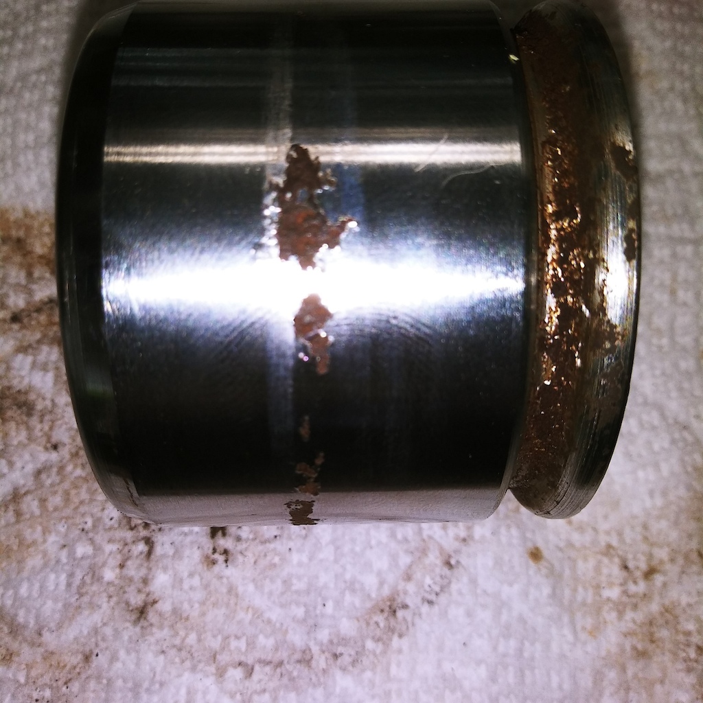

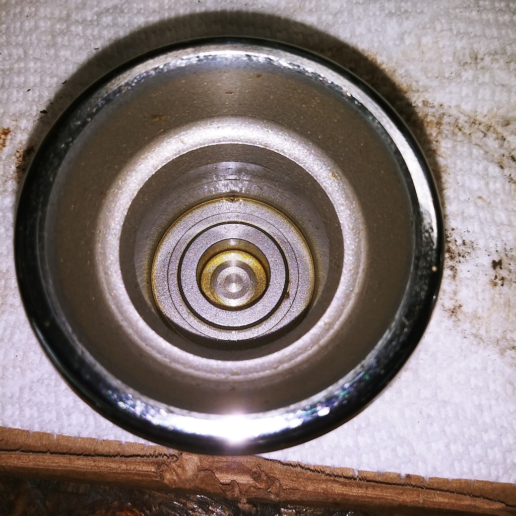

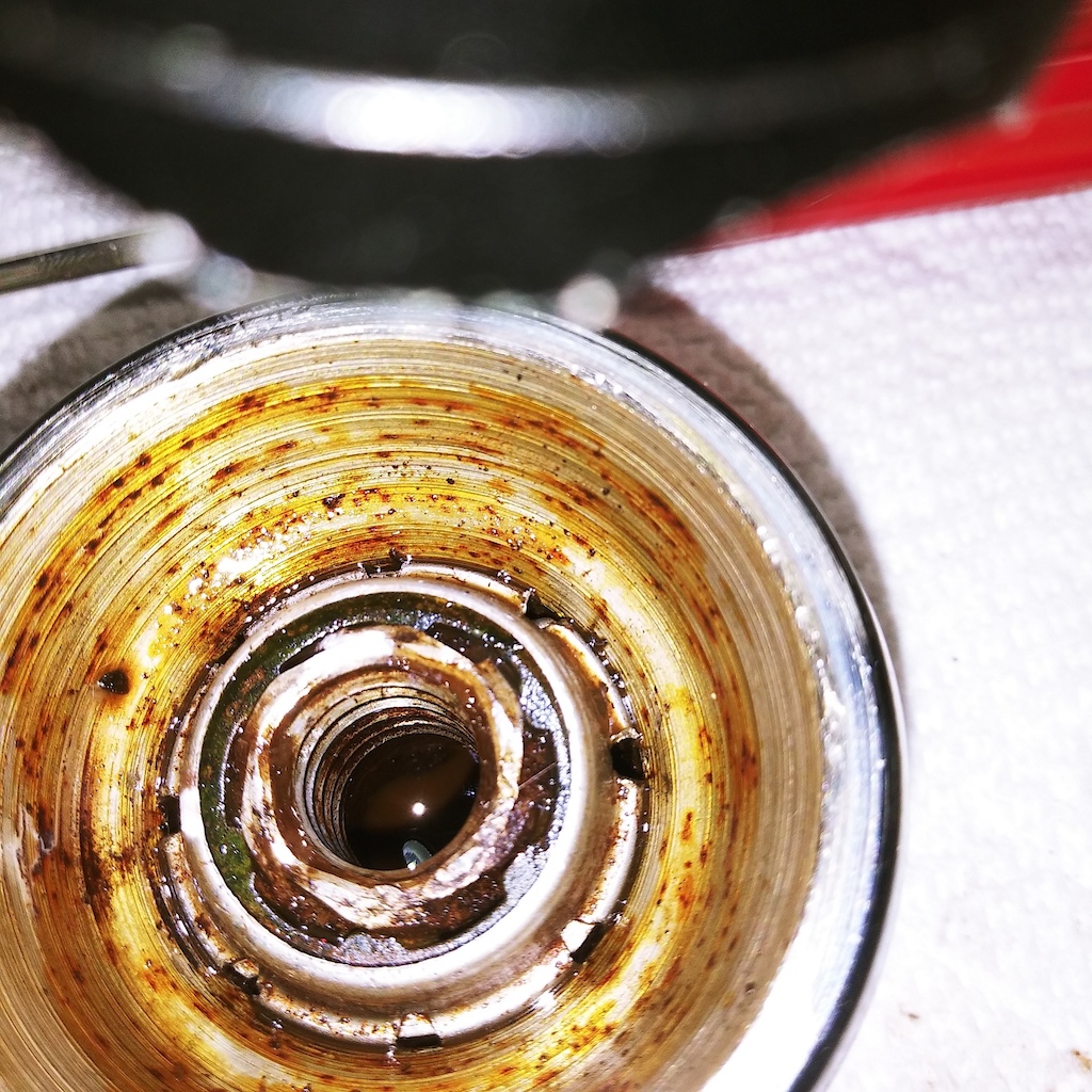

Raybestos DPS85170 Rear Caliper Pistons are still available but they do not have the self adjuster assembly. anyone have exp transferring the org. to a new piston? there is a serrated ring-possibly a circlip under it that appears to hold parts in place but it will not budge.see pics.the oem ford piston #  E25Y2B588A is obsolete.[Image: p5pb25077271.jpg]new piston; [Image: p5pb25077269.jpg]

The whole caliper isn't available? I don't see any gaps in that so-called "serrated ring" that you're referring to as a potential "circlip". I suspect that it MAY be a threaded retainer, requiring a special tool for disassembly. PLUS.......if the second pic is your new replacement, there isn't any groove or female threads in the bore for either strategy. Have you looked on You Tube for disassembly destructions?  <shrug>

8 small insets on the outer diameter ring then beneath it appears to be a circlip but maybe not as there is no groove on the new piston.emailed raybestos as there must be a method if others are buying the bare pistons.zero videos on the tube.zero calipers available but rebuild seal + O ring kits are still available when they come up on ebay." NOS 1975 - 1977 FORD MAVERICK GRANADA REAR DISC BRAKE SEAL KIT D5DZ-2B595-A NEW".https://www.ebay.com/itm/391702493953
